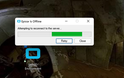

When he enters his credentials, he sees a dialog that reads “Epicor Is Offline.”
Surface E10 Offline
I have seen this dialog before.
Generally, it displays when the Epicor server is not active (while it’s rebooting, for example).
At this time, the Epicor server is up, and working normally.
