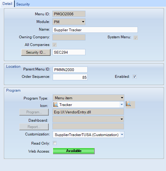

Hi Andrew,

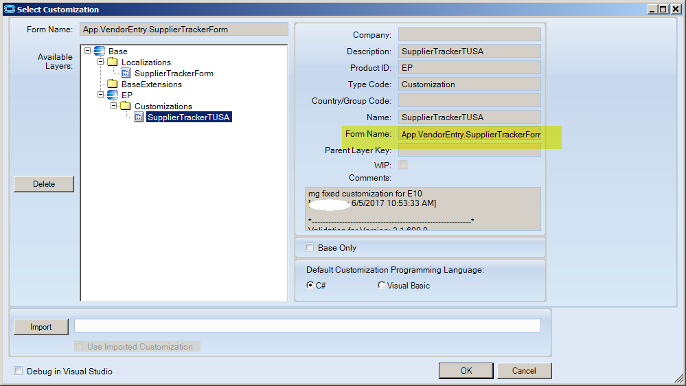

We had to struggle with this during our E9 to E10 upgrade over the summer. I’m sorry that I’ve forgotten some of the details of exactly how it was done, but I’m providing screenshots that might help you move in right direction. I do recall we had to do full rebuild of customization on supplier tracker, it couldn’t be upgraded in E9.
Also, you need to ensure you setup the context menu to call the correct tracker… we had to do it for some of the other trackers (e.g., PO tracker, and I think “where used”, as well, maybe others). Note the form name in yellow highlight on our SupplierTrackerTUSA customization. I believe this was key to getting it done.
Nancy

I did learn that the Menu table must be updated in SQL to get the necessary Supplier Tracker argument into the added menu item for our custom menu groups.
