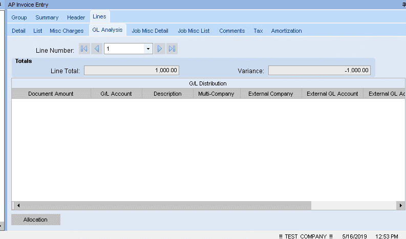

When I go into AP Invoice Entry > Lines > GL Analysis, I am able to add multiple lines with different GL accounts. Is there a way to set it up to bring in multiple default GL accounts into the Lines > GL Analysis or is the system limit to only one GL account and you have to add multiple GL accounts individually during Invoice Entry? Or is this exactly what the allocation set up is doing in our scenario?

You create an AP Allocation in (AP -> Setup -> Allocation) first.
Then during AP Invoice Entry, you can click the Allocation button, and chose an AP allocation that you defined.
Thanks! Your picture video demo helps explain it (how did you upload this?). I’ll do more testing but when I set up the Allocation, I’m not able to select it in AP Invoice Entry in the drop down. Am I missing a step or how does the Allocation get assigned to the supplier?
There are two different Allocation Entry screens (one under GL -> Setup, the other under AP -> Setup). They look identical but only the ones created in the AP-> Setup -> Allocations, can be used in the AP Invoice entry.
Hint: After creating the invoice, you can do the Allocation prior to creating the line. Just enter the line amount in the Allocation Entry pop-up.

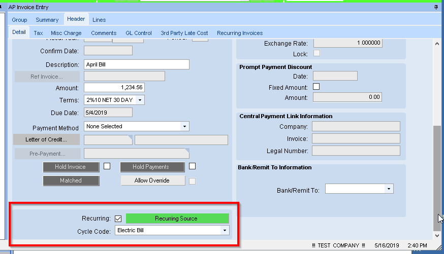

That worked using the AP Allocations instead. I’ll have to review with Finance but it looks like that will work with what they intend to do. Now I just have to see if there is a way to set the default amount for recurring where every month, the amount is always the same for a specific GL account.
I’ve not used it, but there is a “Recurring” settings on the Header sheet in the AP Invoice Entry screen. Requires setting up a Cycle Code
I don’t see either the Recurring setting or where to set up the Cycle Code.
I right-clicked in the Cycle Code dropdown and selected “Open with -> Recurring Cycle Entry”. and
After making that new Cycle Code, you’ll need to refresh the dropdown list for it to show.
