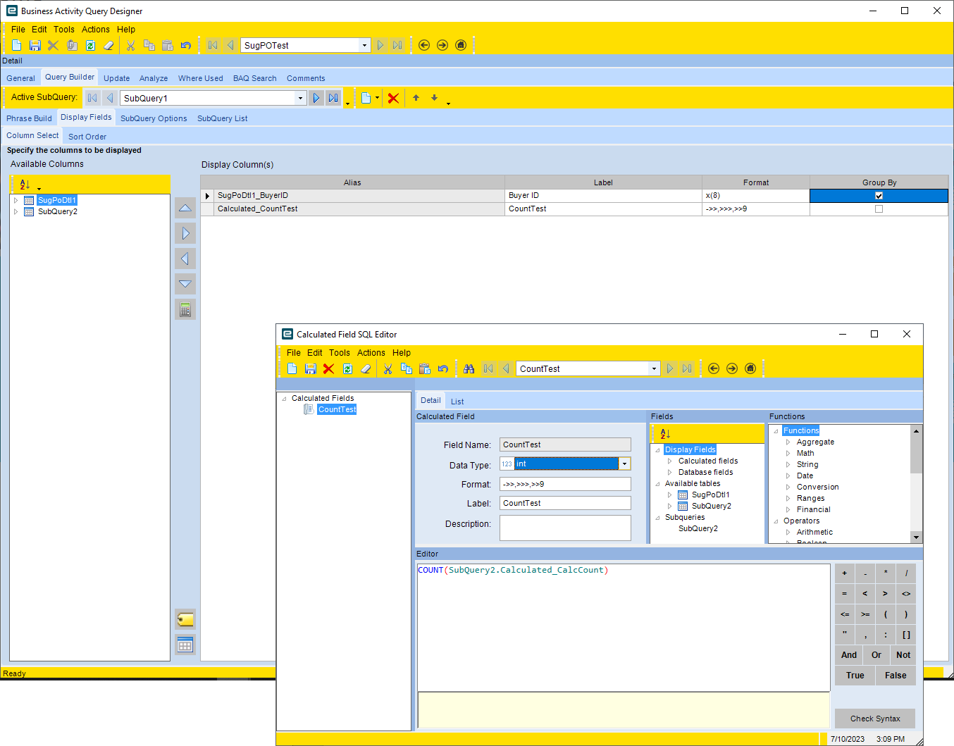

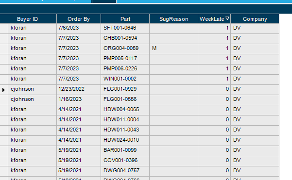

I am trying to get a count of the number of suggestions that are 1 week late (>0 and <=7 days). I have an inner SubQuery with a column that returns a 1 if the number of days late falls in this range. This part works fine. There are about 3k total suggestions, a few hundred fall in this time frame.
Here is my calculation (it works fine):
(case when convert(int,datediff(day, SugPoDtl.OrderByDate,constants.today)) > 7 then 0 else (case when convert(int,datediff(day, SugPoDtl.OrderByDate,constants.today)) > 0 then 1 else 0 end) end)

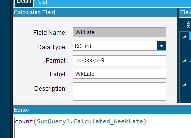

In my top level SubQuery, I group buy the BuyerID and my only calculated field is set up to sum my field that has a 1 if the suggestion is within the 0-7 day range and 0 if not. The problem is I get a total for a buyer that is in the millions. My calculation in the to level SubQuery is simply:
count(SubQuery1.Calculated_WeekLate)
I group by BuyerId. For one buyer, the result is 11,560,464. The total number of suggestions in my inner subquery is only 3,000 so for one buyer to have over 11 million is ridiculous.
Any suggestions will be greatly appreciated. Thanks!

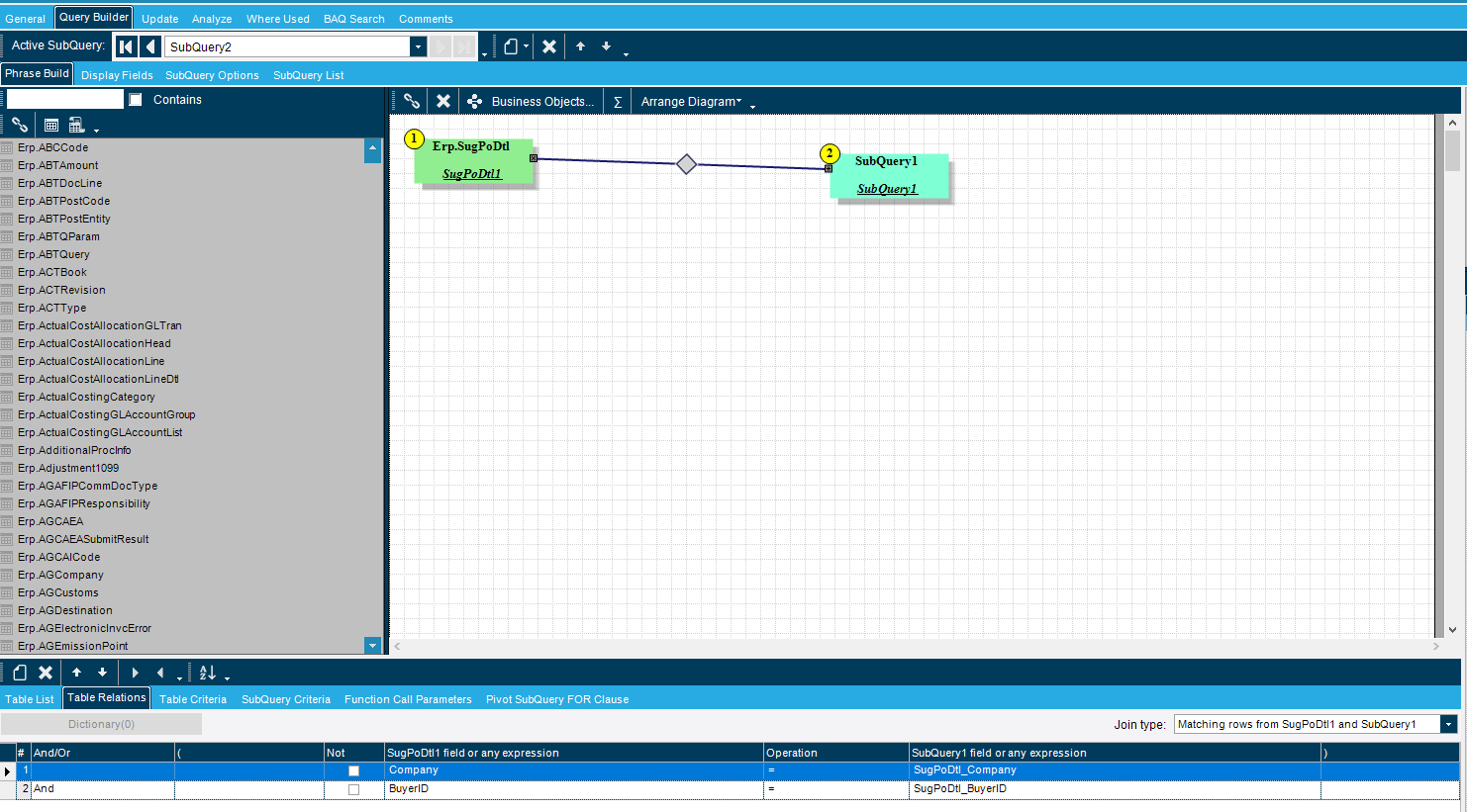

What’s your join to the subquery look like?
Seeeeems fine. I just copy+pasta your formulers and it worked on my end. :thinking:
Top
SubQ
What you have looks like mine but it’s not working. I exported it and imported it. Sometimes that helps. I’ve attached my actual BAQ.
DV_KFTEST.baq (49.3 KB)
Ah–I gotchoo.
Use SUM, not COUNT.
You’re counting all of the records currently, but your formula provides a 1 if it’s in the range. Summarize those to get the “count”.

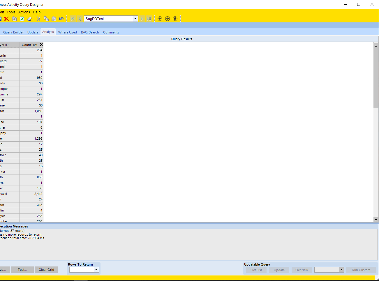

This looks more accurate.
I re-read your initial post and 9,000+ suggestions didn’t make sense on my end, either. It was just divided better, so at first glance it looked ok.

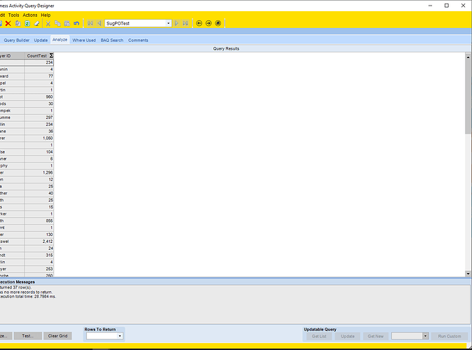

Getting closer. Two buyers show 0 which is correct. The one still shows 18,670 when there are only 3,099 total. The number for that buyer should be 100-200.

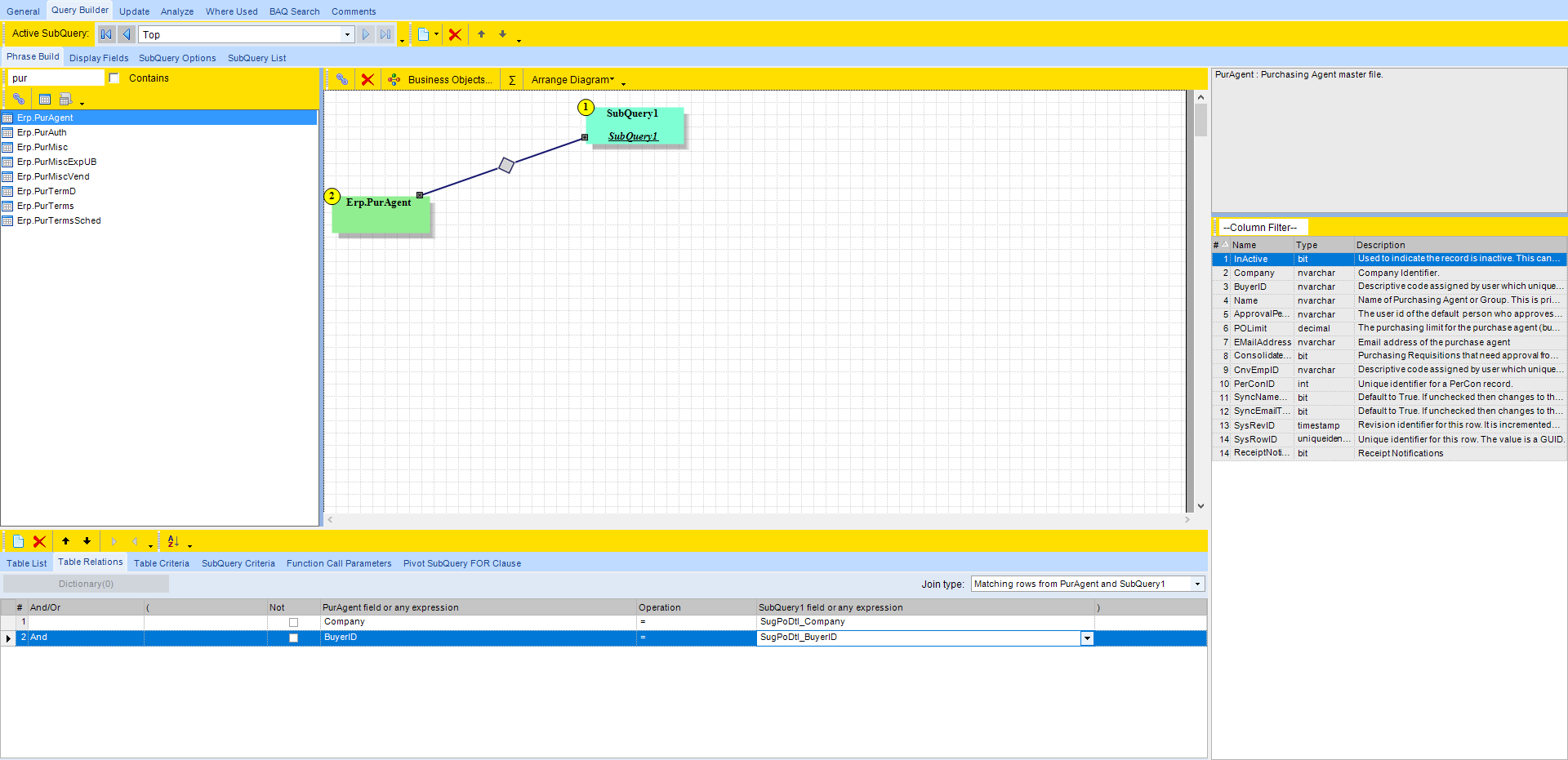

Change your top level table to PurAgent.
If you need more data from SugPoDtl, create a second subquery to pull those records in.
Thanks. I’ll try that.

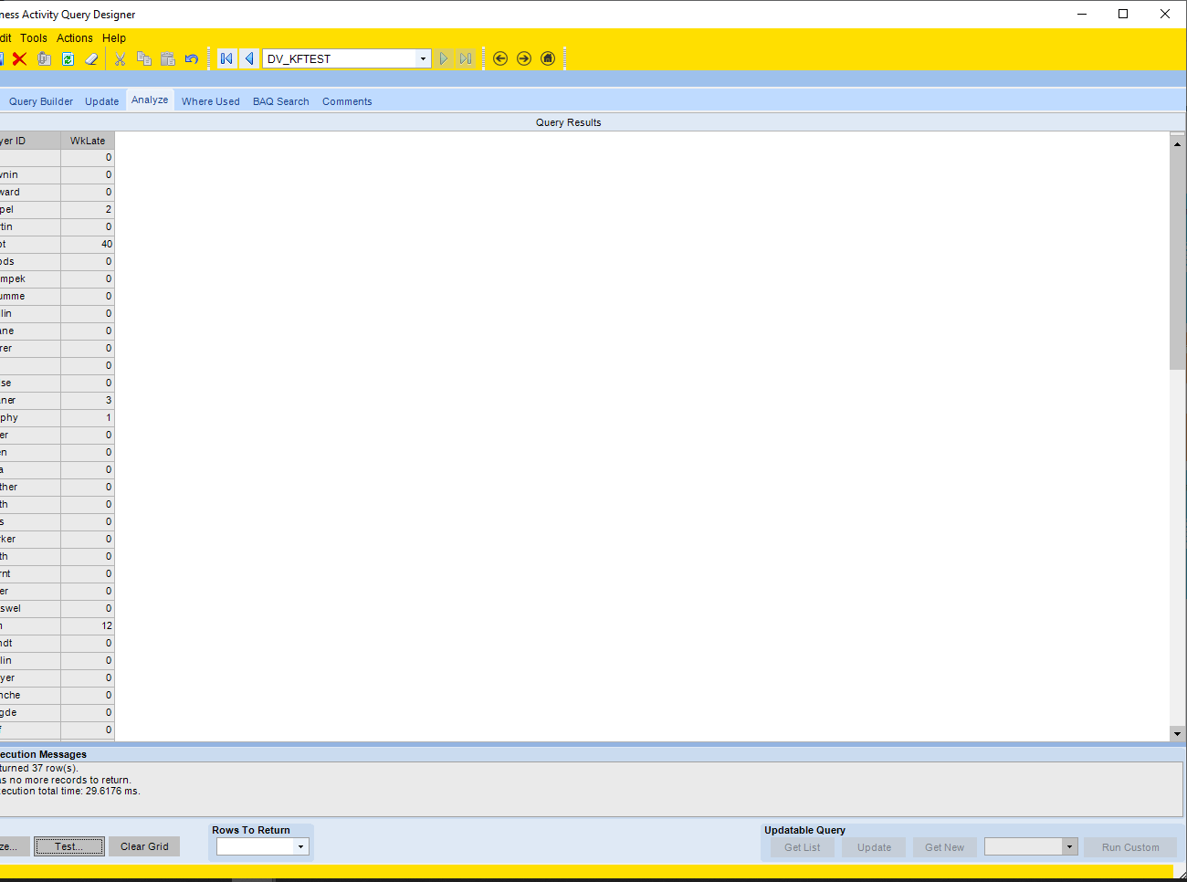

That did it. I don’t get why but it worked. Thanks.

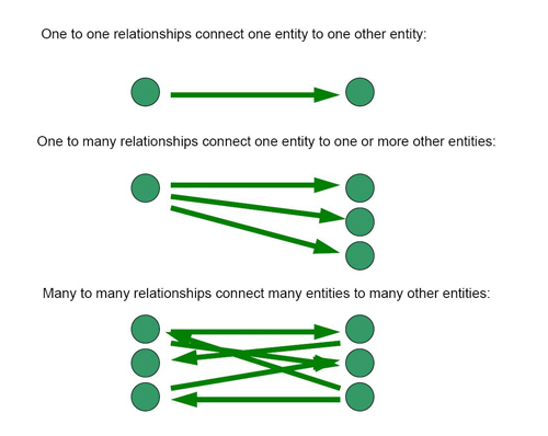

You had it as a many-to-many relationship before.
For each SugPoDtl.BuyerID, you’re linking to the subquery SugPoDtl.BuyerID.
By replacing the first one with PurAgent, you’re making it a one-to-many relationship which allows you to aggregate the fields properly.
Here’s a good visualization if you’re not familiar with relational databases:
