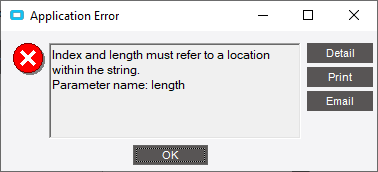

numfield2.Value = val.Substring(val.IndexOf('~'), val.IndexOf('|'));
numfield2.Value = Convert.ToInt32(val.Substring(val.IndexOf('~'), val.IndexOf('|'));
This is the error I keep getting:
I’d imagine some of you could solve this much quicker than I can.
