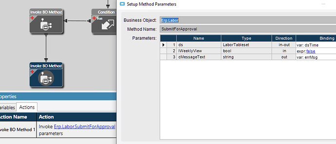

I think submit is a method that you call on this object and not just setting the field. I believe it has to do with approval tasks, even if you are not using them.
NVM. I missed the graphics in the post above…
Thanks to Jacob_Leggatt for posting the code he was having some trouble with, I saw that he called the ValidateChargeRateForTimeType method after setting RowMod to “U”. Once I added code (inside the BAQ, where I wanted it to be) to GetByID, set the RowMod to “U”, then ValidateChargeRateForTimeType before calling SubmitTime, it worked. No idea of WHY that was needed, but if it works, it works.
