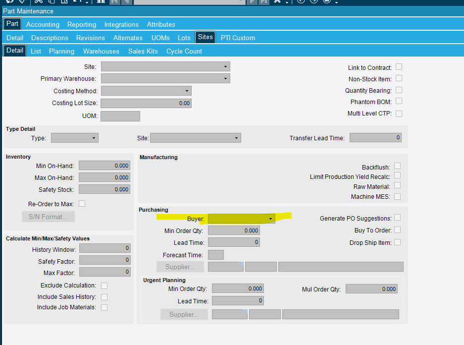

In Part, do you have a buyer set up:
I remember that we had issues not seeing certain things if this wasn’t set up.
Yep. It has a buyer.

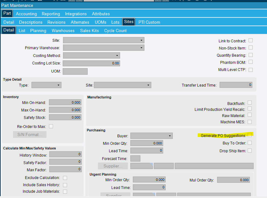

And Generate PO Suggestions is checked?

i was asking myself is "generate po suggestion " is mandatory for subcontracted part, as it is the mrp that generate the PO, and the part is flagged “manufactured”.
in Kinetic, the checkbox is grayed
Aranud
I had this same issue and I found that if Supplier is blank in Site/Details it won’t make a PO suggestion.
