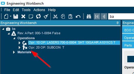

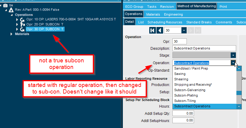

That’s a really good point. Check you MOM and make sure that the subcontract symbol looks like the one below next to subcon. If it looks like the one next to laser, it’s a regular operation and will not generate a PO suggestion (or allow you to attach a PO). Also be careful because you can change the operation on a regular operation to subcontract, but IT’S NOT REALLY CHANGED. I wish they would either really change it, or not let you choose one of those when changing by drop down. (I supposed I could make a BPM for that.)

In my system that check box is not available to change in the engineering workbench. It’s there, but grayed out. I can only change it in the operation master for when I bring the operation in. Is there supposed to be a way to change it without deleting the regular operation and bringing in a whole new subcontract operation?
