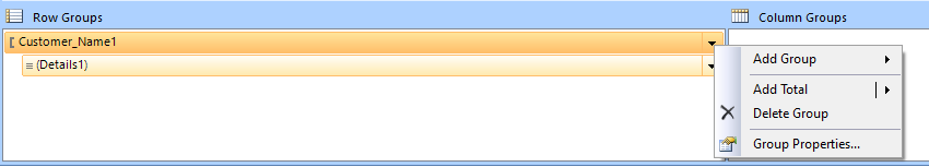

Hi Marc - If you right click on the group, there is an option to add totals. It automatically adds the row or column for you, and then you choose which fields to summarize. Sounds like you need to do that for the Month column group.
When i do this it adds a total to the right, not at the bottom
