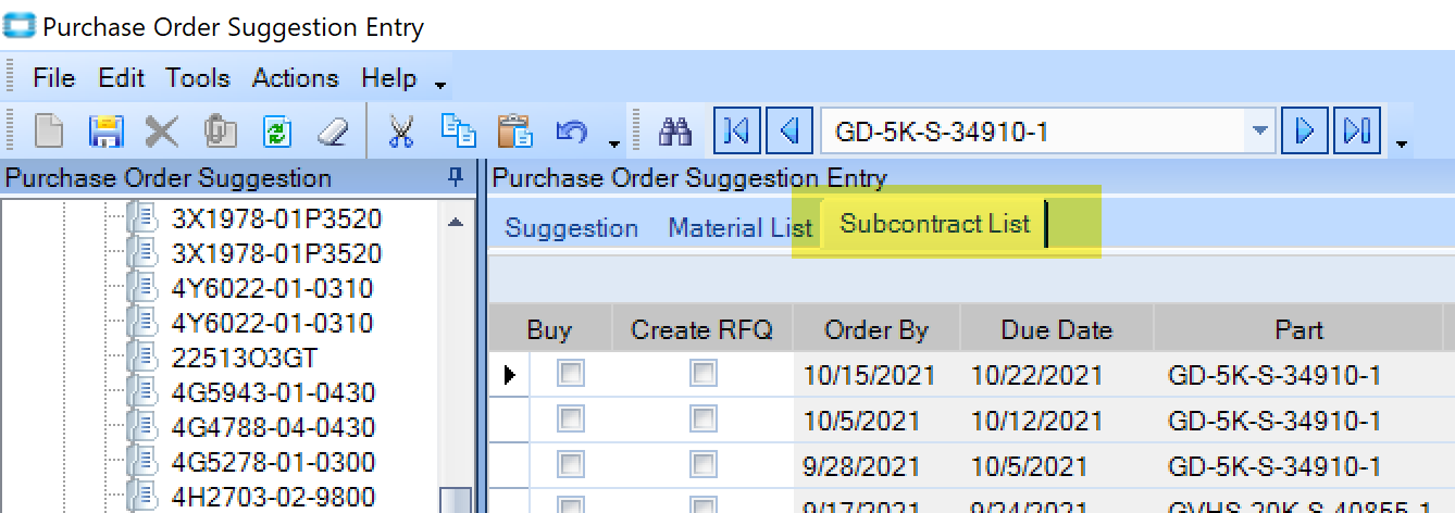

Just a couple of thoughts… first, subcontract operation has its own tab in New PO suggestions. Did you review the correct tab? Second, you will only see the suggestion if you are the buyer or are an authorized user for the buyer on it.

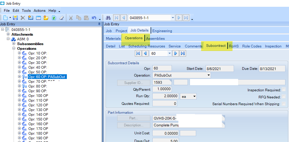

Here’s a screenshot of a job where we currently have a new PO suggestion in system for buying the subcontract, in case it helps. It inherits the part getting produced information in there automagically.
