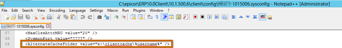

If you change the alternate client cache location on the local workstation’s .mfgsys file (to something like c:\temp\cache), and then try to log in, can the user log in?
Nathan,
Instead of changing the mfgsys, per your idea I just changed the permissions to allow write access on the C:\programdata\epicor folder for the user in question and it fixed it. No clue though as to why it just started happening though when it worked fine two days ago……Strange….Thanks for the idea!!!
