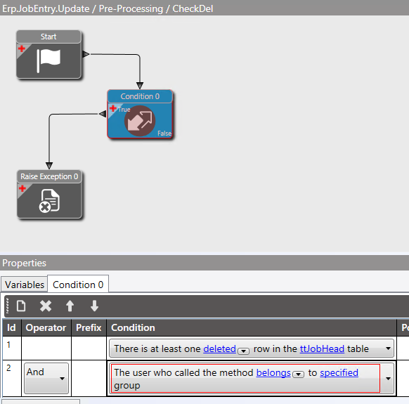

I did some light testing, you will want to fully test this for any loopholes.
Using the BPM below I was able to prevent JobHead deletion but was still allowed to delete Job Assemblies, Operations, Mtls, etc.
You definitely need to have this tied to a user security group since other process (MRP) and users need to delete Jobs.
Method: JobEntry.Update
Pre-Processing Directive
Two Condition:
-There is at least one deleted row in the ttJobHead table
AND The user who called the method belongs to the NoJobDelete group
If true then Raise Exception message that Job Deletion is not allowed

In the screenshot of the JobEntry.Update BPM:
  • Condition 0 checks for to see if it is the whole PO AND the user/group (see prior posts)
  • Condition 2 checks to see which button was pressed.

Are you sure you enabled the Directive?
That directive only checks for the JobHead AND if the user is in the group. Effectively preventing users in that group from deleting the JobHead (whole job).
Anyone can still delete Mtls, Ops, etc…
Anyone not in that group can still delete the JobHead (whole job)
(edited for clarity)

Based on your screen shot of the BPM …
User is in       Can Delete       Can Delete
Adv Prod Team    Mtl, Ops, etc    JobHead
     YES              YES              NO
     NO               YES              YES
Shoot, I forgot to save after I changed the belongs to group to does not belong to the group.
That fixed it.
