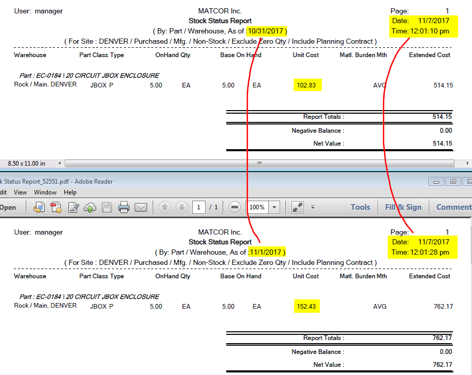

SSR is not showing the proper cost for a given date.
A cost adjustment was made to a part on 1/7/2017.
A Qty Adjust was made on 11/1 with a 10/31/2017 date.
Yet running the SSR for 10/31 (or any date before that) shows the old cost (prior to the 1/7 adjustment)
SSR for 10/31/17 (or any date prior)
SSR for 11/1/2017
and now the really weird thing…
  • The SSR run (and saved) at 12:01 AM on 11/1, with a 10/31 SSR date, and prior to the Qty Adj, shows the $152.43 price.
  • The SSR run with a 10/31 SSR date, and after the Qty Adj, shows the $102.83 price.
  • The SSR run with a 11/1 SSR date, and after the Qty Adj, shows the $152.43 price.

But it must also try to calculate the cost for a specific date. If I run the SSR right now, once for 10/31, and once for 11/1, I get two different costs.
The scheduled SSRS that I run on 12:01 AM on the first of the month uses “TODAY” as the SSR date. Maybe when TODAY is used, it knows it doesn’t have to back calc the QOH and cost, so it just uses the current ones. That could explain why those run correctly.

I used to think that only QOH was back calculated, and that the current cost was always applied. But the following shows that it “tries” to back calculate the cost, as two different costs are shown when using a SSR date prior to today.
The following is the built-in SSR report (original RDL file), with the built-in RDD for the StkStat report. Run with SSR date of 10/31 shows a unit cost of $102.83. Running it with a 11/1 SSR date shows the unit cost of $152.43. So it is definitely trying to back calc the Cost for the SSR date.
My problem is, that the cost of the part on 10/31 was $152.43, and had been that since 1/7/17. Yet it shows up on the SSR as the price from prior to 1/7/17.
