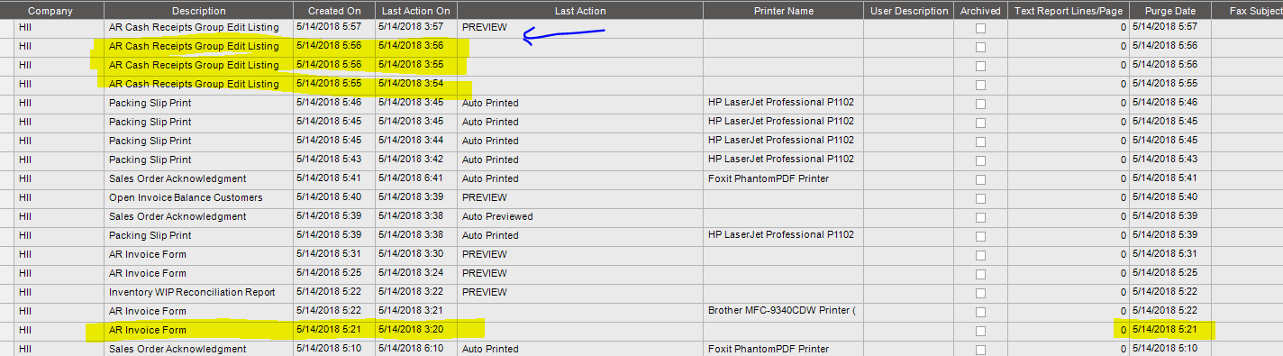

I have a user who will submit reports to be processed, but nothing happens. This happens in the afternoon each day. Here is a sample of what I see when viewing all items. The ‘Last Action’ will be blank and then after a number of attempts a report will preview.
We have tried closing and reopening the application to see if this will fix the issue. The user reboots their machine every 2 days.
Any thoughts of things I can try?
