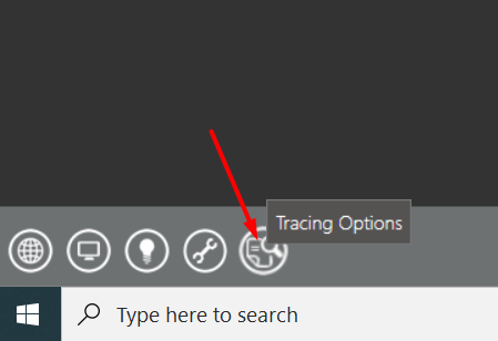

thank you for your answer. I have a doubt, how do I enable the logs to be able to compare the in and out data? Is in Tracing options Forms?
Thank you
Client tracing, bottom of the homepage (note this is E10.2)
Anything further, please start a new thread.
