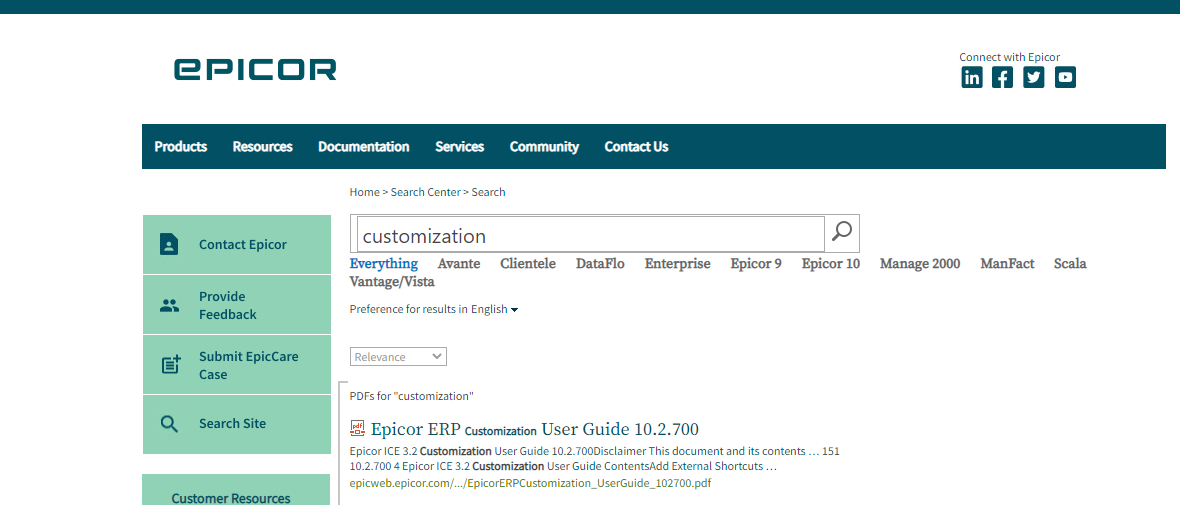

Hi @Nuruchima ,
Go to your EpicWeb account and download your version of Epicor’s Customization documentation and read through carefully.
https://epicweb.epicor.com/
For more advance stuff, this forum is the best place to ask questions :slight_smile:

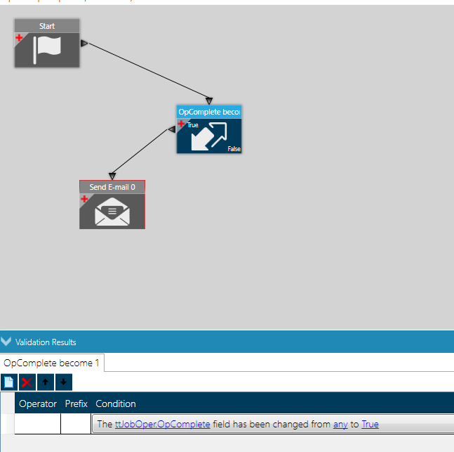

For the project you were tasked with, you could use a Data Directive. You’ll want to reference the Business Process Management section of the ICE Tools User Guide for your version. Most of the work you’ll do with be in the ERP10 Environment.
I’m not familiar with how Epicor knows which sequence a job is on. However, with a Data Directive you can tell Epicor to send an email when a data field changes to a certain value, for example.

I assume by “when a job is moved to a new sequence” you mean when an operation is completed (thus moving to the next operation).
You should be able to create a Data Directive on LaborDtl when the Operation is marked as complete and job complete is not checked, send an email.

When a job is moved to a new sequence, I guess you mean when an operation complete. You can create a Data BPM to monitor the JobOper Complete flag.
