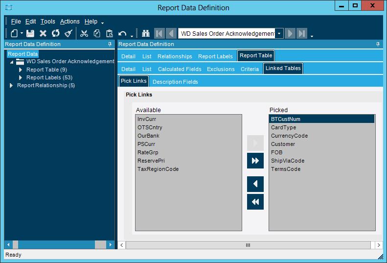

I made a copy of the OrderAck RDD and added the OrderHed - BTCustNum Linked Table and some fields from it:
But when I Sync my Dataset and run my report I get the following error against the newly added BTCustNum fields:
I’m afraid to ask because we use Linked Tables a LOT in E9 RDDs for our Crystal Reports… :fearful: …but do Linked Tables no longer work in E10 with SSRS? Or how can I get them to work in my SSRS report? Do I need to add a Report Table now and create a Relationship? It was so nice to just use these Linked Tables without having to bring in a new table and create a new Relationship, etc.

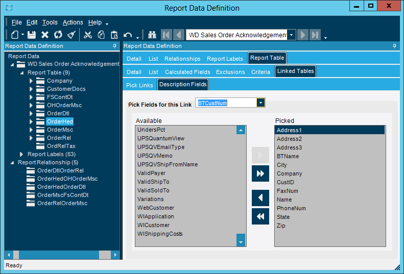

The links work. Going to start with just making sure you have selected the fields you need. Can you take a screen shot of the Description Fields for the BTCustNum link?
Sure! Here it is:
Thanks.
