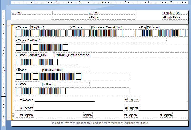

This is what the final tablix looks like, but the spacing is ridiculous. I was able to get the blank space to go away by setting the Serial Number and Lot Number text box fields to “Allow height to decrease” but that’s even more tedious than moving the rows around. Going to see if I can find some way to apply that property to multiple fields at once.
I went ahead and did it also. Here is what mine looks like.
What I wound up doing was copying the row visibility that each field came from and setting the object visibility to match.
So if you select barcodes, it shows and if you don’t, it shrinks and hides them.
Below is en example of both.
