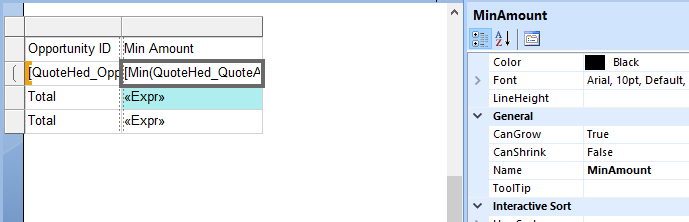

Here’s the total expression: =sum(ReportItems!MinAmount.Value)
And where I named that report field/textbox:

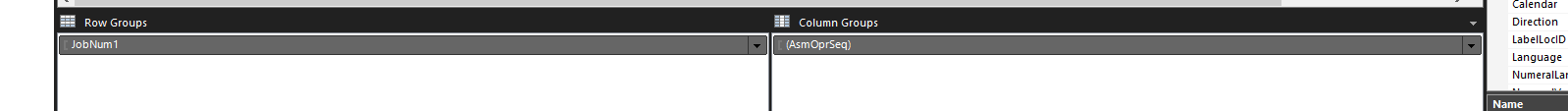

Can you show me your group names?
TOTAL Field Expression: =Sum(Min(Fields!QuoteHed_QuoteAmt.Value,“YOUR GROUP NAME HERE”))
JOBNUM1 is my group name in my picture above. Your group name is whatever your detail group is in the Row Groups section of your report.
That was it!! Thank so much, Utah!
