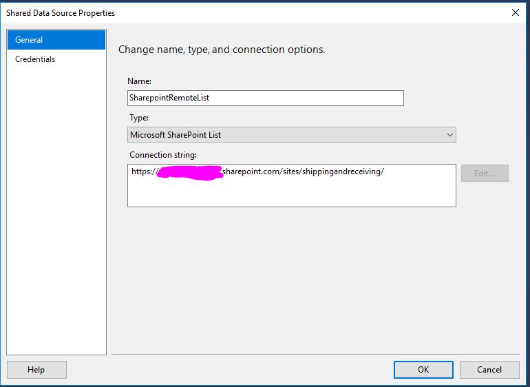

Has anyone created a shared data source that connects to an online SharePoint list?

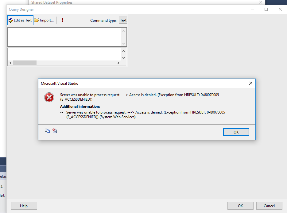

I can’t seem to get it to connect. All the articles I find say, enter the connection string (I did this) and then create a dataset using the datasource (I did this), and then click Edit Query and you should see a list of objects to select from… Instead of seeing a list I get Server was unable to process request. —> Access is denied. (Exception from HRESULT: 0x80070005 (E_ACCESSDENIED))
(Microsoft Visual Studio).

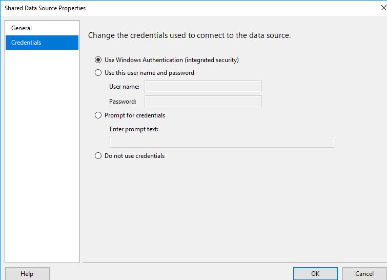

I am not sure what to do about the credentials, I have tried all the option available to me in report builder. I can’t seem to connect to the datasource.

This is the error I am getting when trying to open the query editor in my dataset after creating the Data Source:
“Server was unable to process request. —> Access is denied. (Exception from HRESULT: 0x80070005 (E_ACCESSDENIED))
(Microsoft Visual Studio).”

  1. Create the Data Source
    a.
    b.

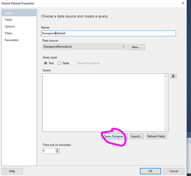

  2. Create the Data Set using the Data Source – This is where I am having trouble.
    a. I click the Query Designer and expect to see a list of SharePoint lists from that site, but instead I get an error message.
    i.
    b.
Do you have any idea why I am being denied access? I don’t know SharePoint that well, but I do know that my user has access to that site.
