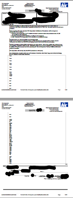

Hello,
I am modifying the Quotform to add a row directly above the Header Comments row that only shows for one company.
It works great unless the combined length is slightly over the length of the page.
It then pushes everything from my new row down to the next page.
If the entire length of the New row plus everything below it is a lot longer than the page length, it splits correctly.
I have added the new row, added a rectangle in that, then added the textbox in the rectangle. I did that because I need the text to start about an inch from the left margin to line up correctly.
Anybody have any ideas?

Hello,
I just made sure the textbox was set to Cangrow: false and resized it to show all contents. I also left a small space at the bottom. It still pushes to 2nd page when printing.
I then added an empty row below the row I added as a buffer, same thing. Still pushed to 2nd page.
I also made sure that the textbox KeepTogether was set to false. No help.
Any other ideas?
