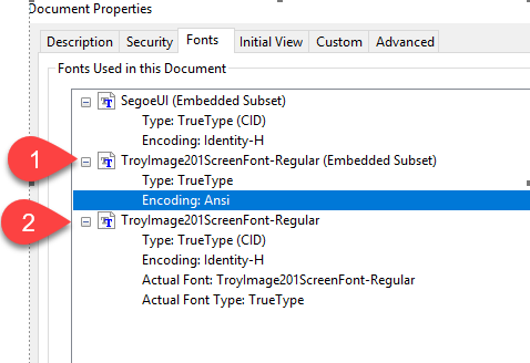

So I was able to resolve this. After digging around I noticed the below.
1.) This is how the font is getting passed via print jobs or save as PDF
2.) This is how the font looks if added via text in the PDF Editor.
So the issue is the font is not correctly getting embedded when printed to PDF out of Epicor/SSRS.
I believe this is because of the type of Font Embeddabiliity
So the only solution I have been able to get to pass the signature is to print via EMF in Epicor 10 with SSRS reports.
