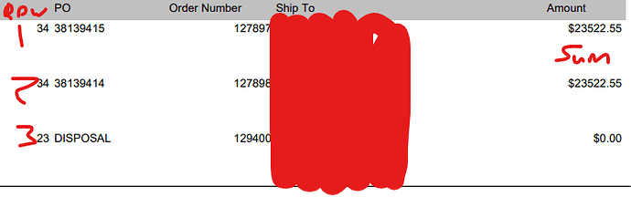

Yes. RowNumber(Nothing) and RowNumber(“GroupName”) give the same output. I assume this means that the rows are created to make the sum and then hidden before the final result. Here is an idea of what I am looking for and what I get now.

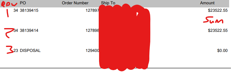

I had an idea on the way to the office this morning that seems to have worked. I merged the RunningValue function with a CountDistinct like this:
=RunningValue(CountDistinct(Fields!Calc_ponum.Value), Sum, Nothing)
and it seems to work great:
