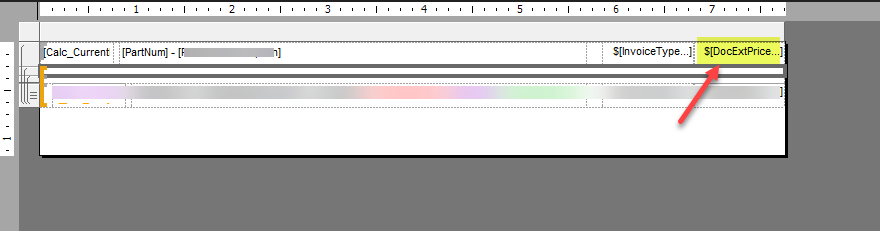

What is the best way to sum grand total a calculated text box within a group? In the example below, each part will have a calculated sum total value for each row. I then want to sum all those grouped part’s total into a grand total. I tried doing a sum on the text box name but that didn’t work.

What is the calculated_OpRow.Value=1 referencing to? I am trying to sum the value of the calculated field. For example, the $(DocExtPrice) text box is already a calculated field and just need to sum total it for all rows within that subreport.

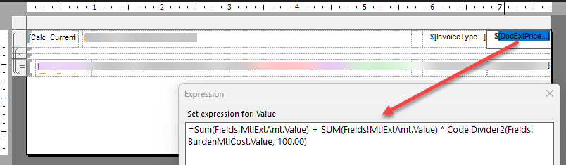

I believe that in SSRS you don’t sum the field names, you can only sum the values from the table (datasource) So instead of trying to sum the calculated DocExtPrice text box, make the expression for your sum a compound expression that says sum(whatever the expression is that returns the text box value). Make sure you make a group (you will need some field to group by) so that you can sum the values in that group.

Below is the Text field’s calculation. It is already grouped by Part number so we want to sum that text box field’s Group By of all Parts.
