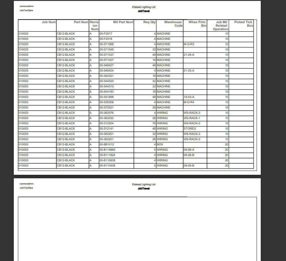

Hello I have made a BAQ SSRS report it works fine however it is meant to print two pages however it prints 4 with two of the pages being blank

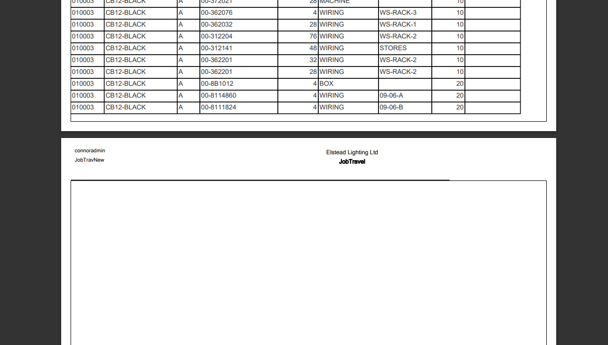

i tried you fix same issue
Change the page width in your page layout (circled).
This should not stick out past the page width.
Nate is so right here. It can be tough to find the guilty element but just keep at it until you have all elements within the borders.
