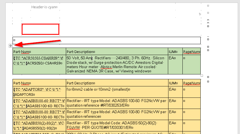

I made a report that lists Parts, with two identical tablixes, but the first filters PartNUms < “AD”, and the second filters PartNums >= “AD”
While that does make two distinct tables, I selected the first (using the table grip pointed to by the arrow), and filled it in green. Then selected the second, and filled it in yello(-ish)

FWIW - I only confirmed that it creates tables within the tables.
If your single tablix design creates a table with 1000 rows, and you break that into two tablixes of 500 rows each, that makes a nested table, with the outer table having just 2 rows, and each of those two rows having a table with 500 rows each.
