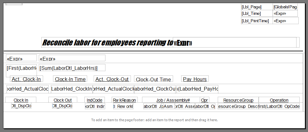

Here are the groups. Its just one big group since they all return multiple times

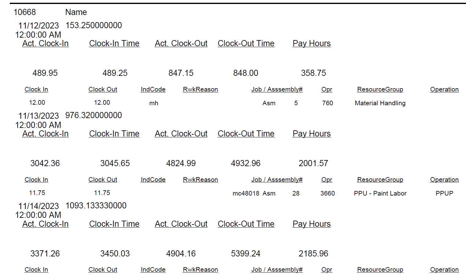

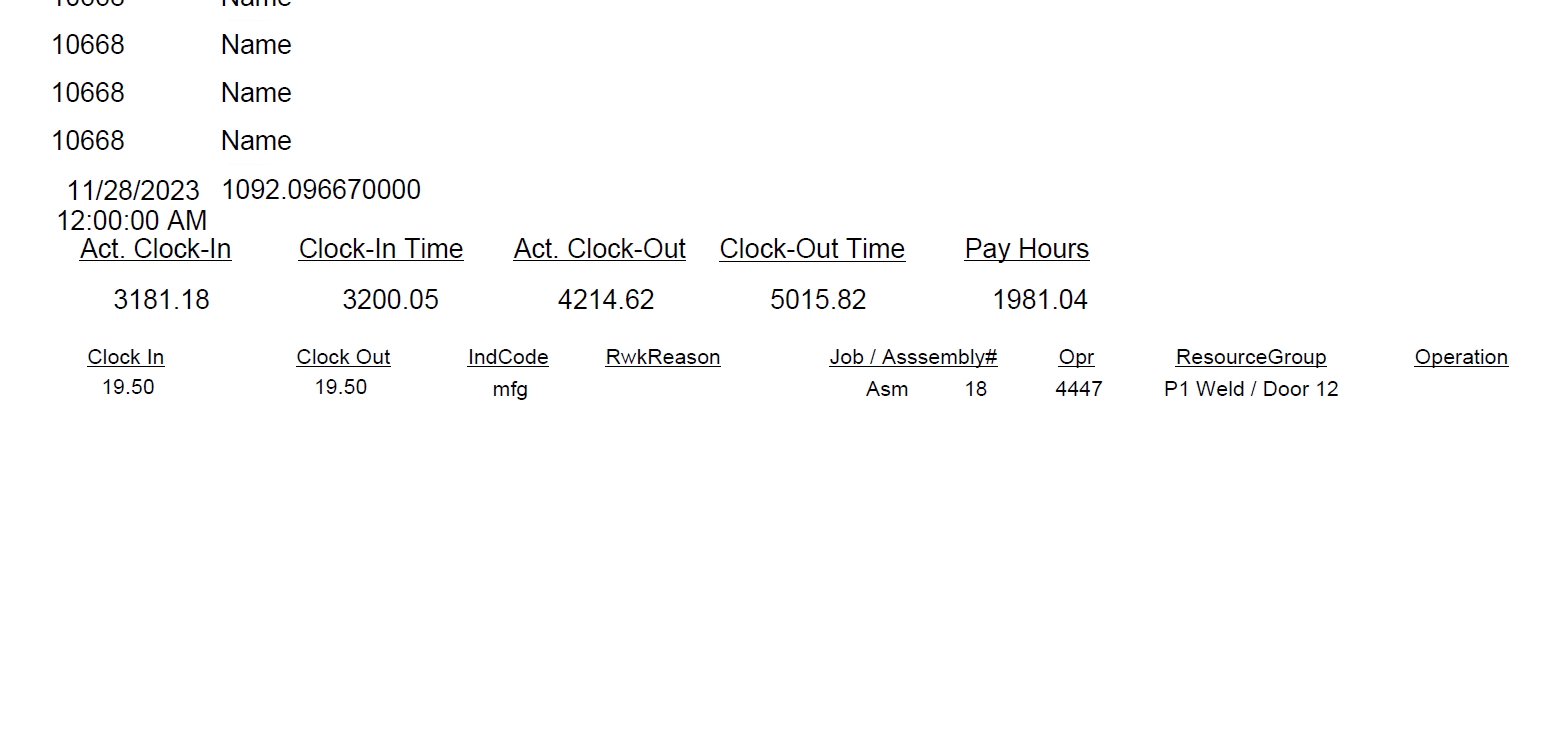

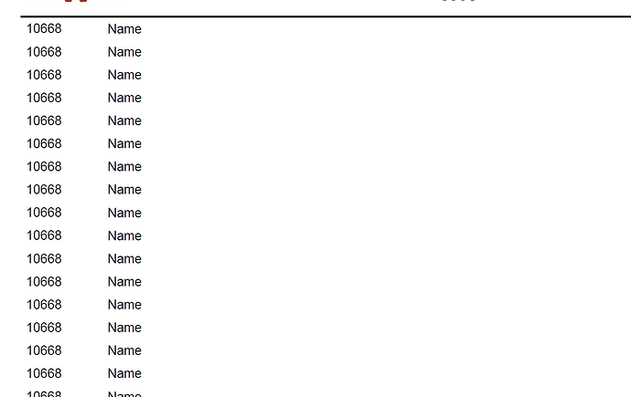

This is what happens
With the last page returning the thing once. I’ll post a screenshot of what I a trying to make it look like. I am converting .RPT to .RDL
The expression in that first field makes me think that you have grouped it all by the first record. Remove the “First” from the expression in that first field. Also look for grouping.

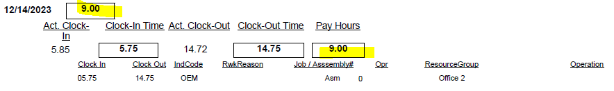

The report is supposed to give you the number of hours a person worked. It does that but not for every entry, just the first. Sometimes it displays wrong which is odd.

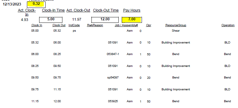

Here in this first picture, the pay hours should equal to that top number, supposed to be total labor hours. In this example, the numbers should be the same. However the reason the field isn’t duplicated is because in the first example, that person did not clock out at all. They smaller clock ins/outs are for jobs. They do one job then move to the next but still clocked in on the job, just different tasks.

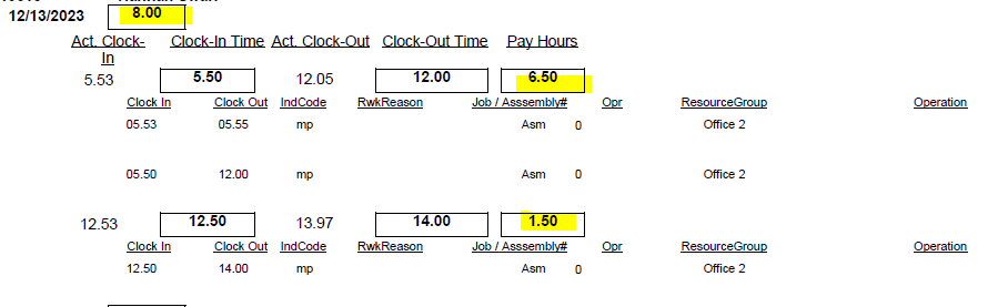

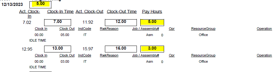

This person worked 5 hours and then took a lunch break. They returned and put in 3 more hours of work. The top total labor hours should say 8 but it doesn’t. It isn’t combining the two totals. Here, they clock in and are doing one task, unlike the previous example.
If somebody does not take a lunch at all, then it works perfectly.
Here is somebody powering though their lunch break.
It seems like it is only displaying the first entry and not combining the two. However the first picture doesn’t match that pattern. Is this an SSRS, BAQ or DataBase issue?
SSRS probably. Throw a SUM in front of that field and see what happens.
=Sum(Fields!LaborDtl_LaborHrs.Value)
Like that?
Whoo! Thank-you! It works perfectly!!
