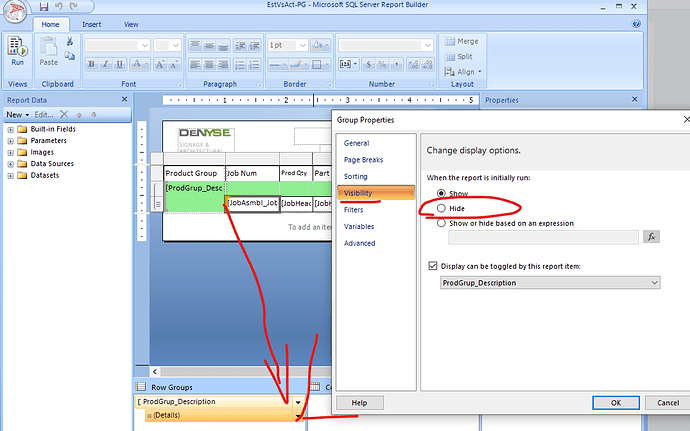

#3 - You can have your group Visibility set as Hide by default. Then the user can open the group of the Parts they want to look at.
I believe this is what you were asking.
That is what I’m trying but nothing happens when I run the report :frowning:
Are you running as PDF or Excel?
Unfortunately I don’t trust my users all that much :wink:
PDF but after you asked I tried Excel and it works in that format. The videos I’m watching looked like he was in PDF but this works (just have to retrain users to use Excel sometimes!)

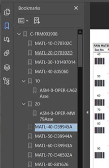

So, if you take this concept and run with it, you should discover that many things beyond Page labels can be added here. For example, using Expressions, I added my own labels and incorporated them with field values to make the Raw Material subreport portion of data stand out. Like so:
=“MATL-” & Fields!MtlSeq.Value & “-” & Fields!PartNum.Value
Or like so:
=“ASM-” & Fields!AssemblySeq.Value & “-OPER-” & Fields!OpCode.Value
This results in a PDF with additional Bookmarks like so:
