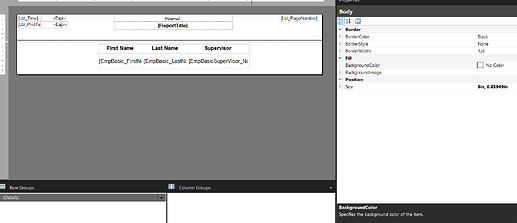

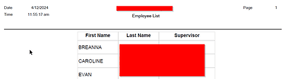

The BAQ works great, I’ve created the ReportID, and when at the point of designing the report. In Microsoft Report Builder, my header is find, I’ve added a table then put in my datasets for the above mentioned fields.

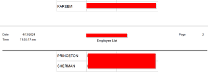

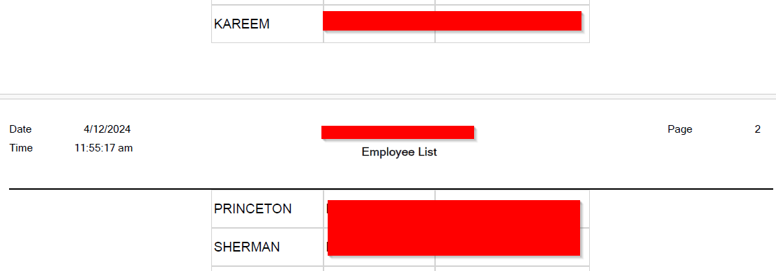

The issue I’m having is my table headers do not repeat after the first page. The table just continues.

*Inserted a row “Inside Group” above my dataset row, This adds the headers after every returned cell

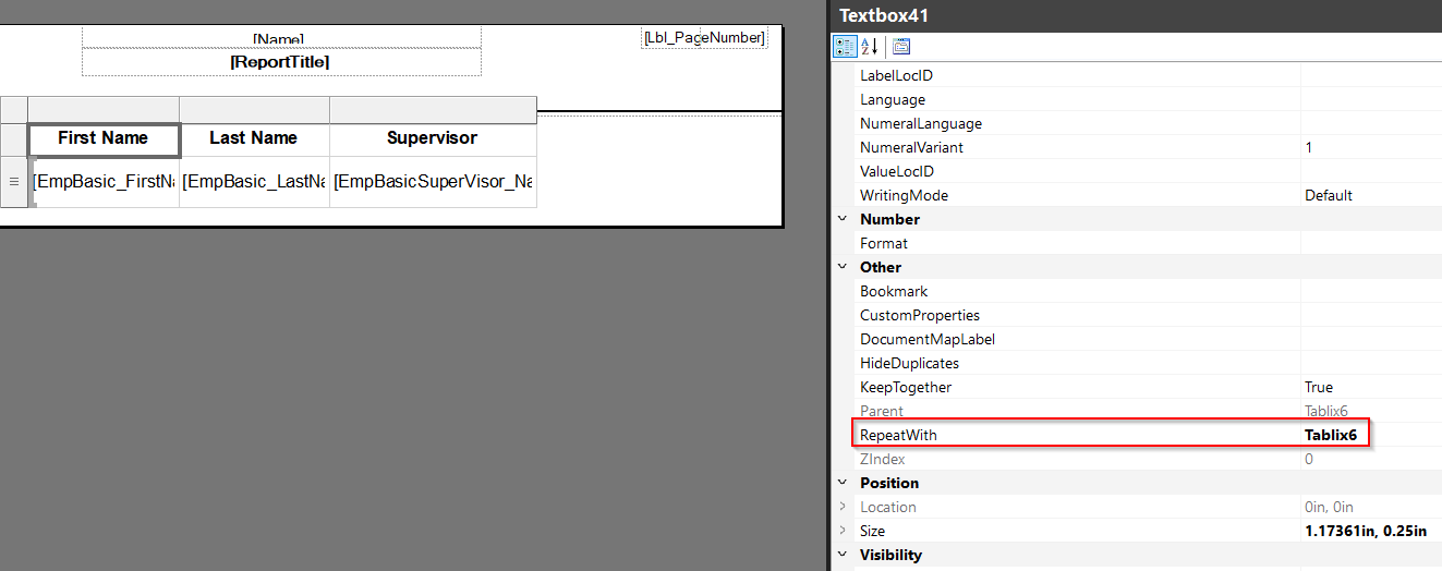

*Set Repeat with for the header textboxes to the tablix

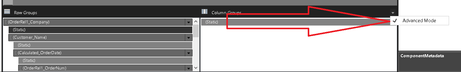

Mr. Kyle: Try enabling the “Advanced Mode” for the group and then selecting the static row that you want to repeat and set the property “Repeat on new page”.

Hey Dave, that did the trick for me. I saw that recommended on other related issues, but was unable to locate the “Advanced Mode” option. But, with clear eyes after this weekend I was able to get it. Thanks!
Thanks for the suggestion Nate, I had seen that recommended before on other related issues. But Dave’s suggestion actually did the trick!
