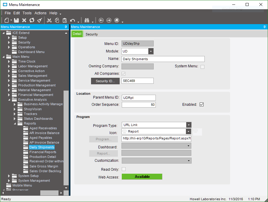

The only way I’ve been able to do this is the use the URL Link type with
the URL to the SSRS report.
