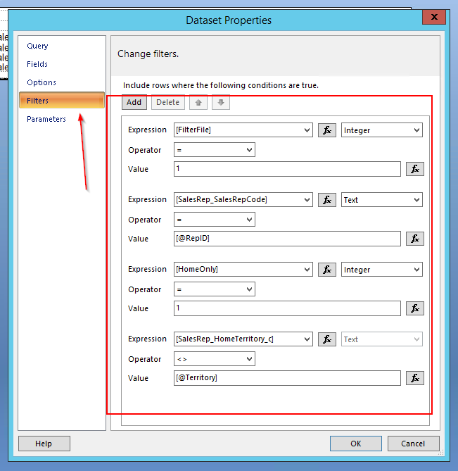

DO NOT, I REPEAT, DO NOT Filter the Subreport in this Tab
Because of the nature of SSRS and Epicor being a “dynamic query expression” SSRS is unable to apply filtering ahead of time so it executes the dataset first, and then it filters. This means that if the data you are retrieving from epicor is 40K rows worth of stuff, and you are running your subreport (say a summary per line) you would end up running 40K times the number of Details which is a VERY VERY Large number.

Do your subreport filtering inhere
Simply add a whereCluause with your parameters to the Dynamic SQL Expression
This way the data will be filtered properly and you will be much happier. You have probably been doing it “wrong” for years without issue because you are working with small data-sets but trust me if you ever have a large report you will want to do this the right way.
Note in the example above we went from 1.5 hours to 9 seconds… that is a GARGANTUAN gain in performance.

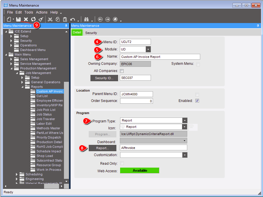

  7. Create a menu item to run the report from.
At this point, you should be able to run your report like any other report.

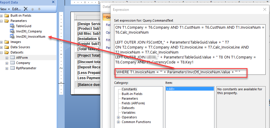

Does this work on standard reports? I’m working on a modification to our SSRS ARForm and I keep getting errors. Do you have to put all Parameters into the where statement?
I’m not the expert on the actual RDLs but I think I can say what you are doing wrong. The RDL Parameters area you are pointing at ONLY gets the TableGuid filled in when the report is run. The report parameters that come from the report UI would be in the Datasets\RptParameter table. I would go to the E10 documentation. There should be documentation on how to add parameters to existing report. If not, you could ask the docs guys to add it.
@Randy you don’t need single quotes around the InvoiceNumber but otherwise it looks fine. What error are you seeing?
