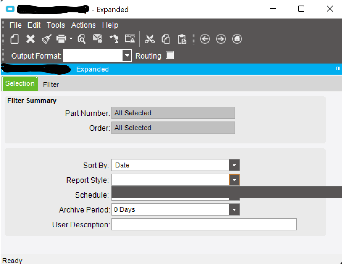

Created a report from the BAQ and it doesn’t show any report style.
I test it in the BAQ Report Designer and it tells me that Report Style not found.

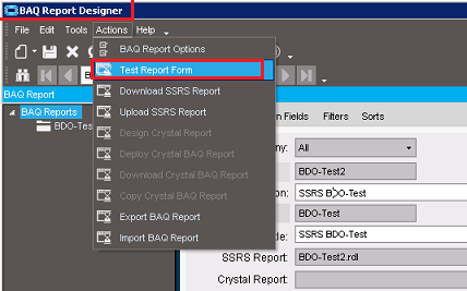

Just curious, if you used “BAQ Report Designer” to set up your report
and if so… what happens if you try “Test Report Form”
When I’ve used “BAQ Report Designer”, it auto-created the style at the same time…

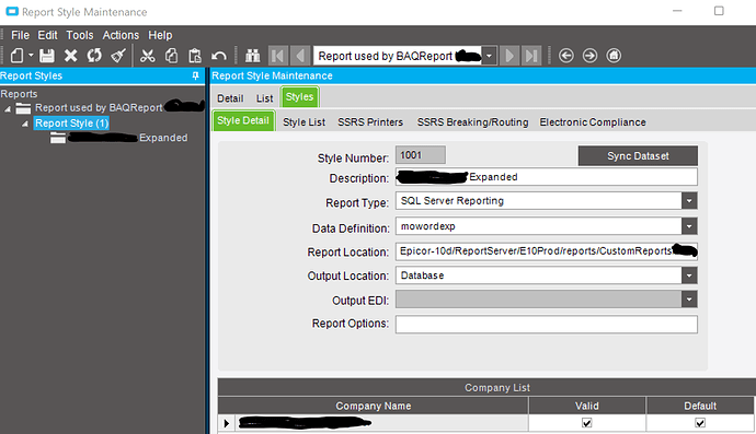

The first screen shot is from the Test Report Form.

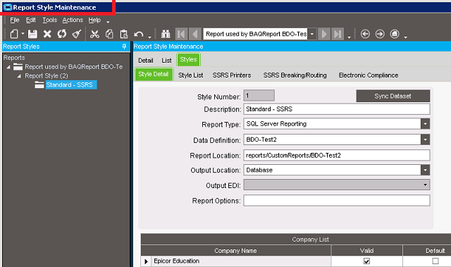

The Report Location does not look correct. Can you compare it against an out of the box report?
I created a new baq report and it looks like it picked it up the second time. I’m going to test it out further. Thanks!
Not sure what happened, but when I started over in Report Designer everything picked up as it should and I didn’t have to do any manual input for the SSRS info.
