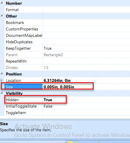

I tried your suggestion. I zoomed in 400% and made all the Field Size = 0.005 and set Visibility/Hide = True.
I moved everything in the Sub-Report as close together as possible…BUT…
It contains a Table(Tablix). I simply want to sum the contents of the Table, place that SUM in the Footer then pass it back to the Main Report. Even with a very small size, this Total in the Sub-Report shifts down.

SizeHidden
