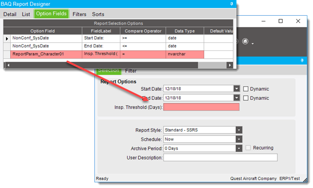

I am currently wrestling with a generally simple “IIf” evaluation on an SSRS report. The evaluation takes a calculated field from an underlying BAQ (because this is configured as a “BAQ Report”) and evaluates “greater than or equal to” a value derived from a report option field passed along to the report:
report-options
