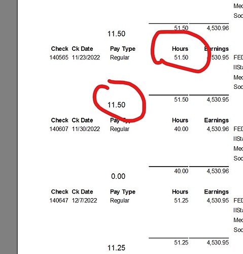

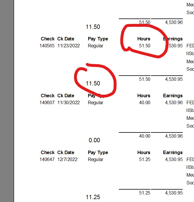

attached is a screen shot
I think I’m misunderstanding something. Your screenshot looks like the math is working out just fine. Your bottom number is 40 less than your top one for each grouping.

Assuming you’re trying to show hours above 40 for this field?
Are you sure this field is properly within the same report grouping?
@ajr117 You look to be outside the row grouping based on the image.
Also, you should be able to sum (the total) like this using a scope in the SUM function:
=SUM(Fields!Labor.Value,"WeekOfYear")
