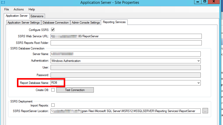

Where did you find the reports database? Is this a separate database from everything else? What table is the report data stored in? I have gone through looking at various tables and databases but haven’t been able to find it.
Are you looking for the DB that holds the tables the end with the GUID, that are used for the report? Or the DB that holds the RDL “files”?
The former (xxxx_GUID tables) are in the DB specified in the EAC configuration, on the Reporting Services tab, the ReportDatabase Name field. mine is RDB
Expanding that DB in SSMS, you’ll see tables with famailiar names with GUID suffixes. These are the temp datasets that the RDD (or BAQ) generate for SSRS reporting.
