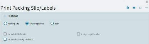

If a legal number has already been assigned, when you go to view or print shipping labels, the Assign Legal Number will be grayed out:
