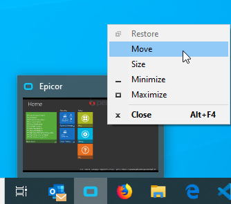

If you right mouse click and choose Move, press the left arrow and then move the mouse around, can you bring it to a screen?

Right mouse click on the epicor shortcut?
Let’s see, I hover the icon in the Task Bar, when the icon floats, right mouse click, choose Move
I unpinned it from the task bar. I’ll try repinning it so I can see it in the task bar and then try that
