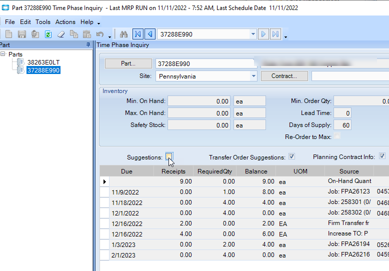

You can also uncheck suggestions on time phase inquiry to not see the effect of the suggestion(s) on the QOH calculation.
Nancy

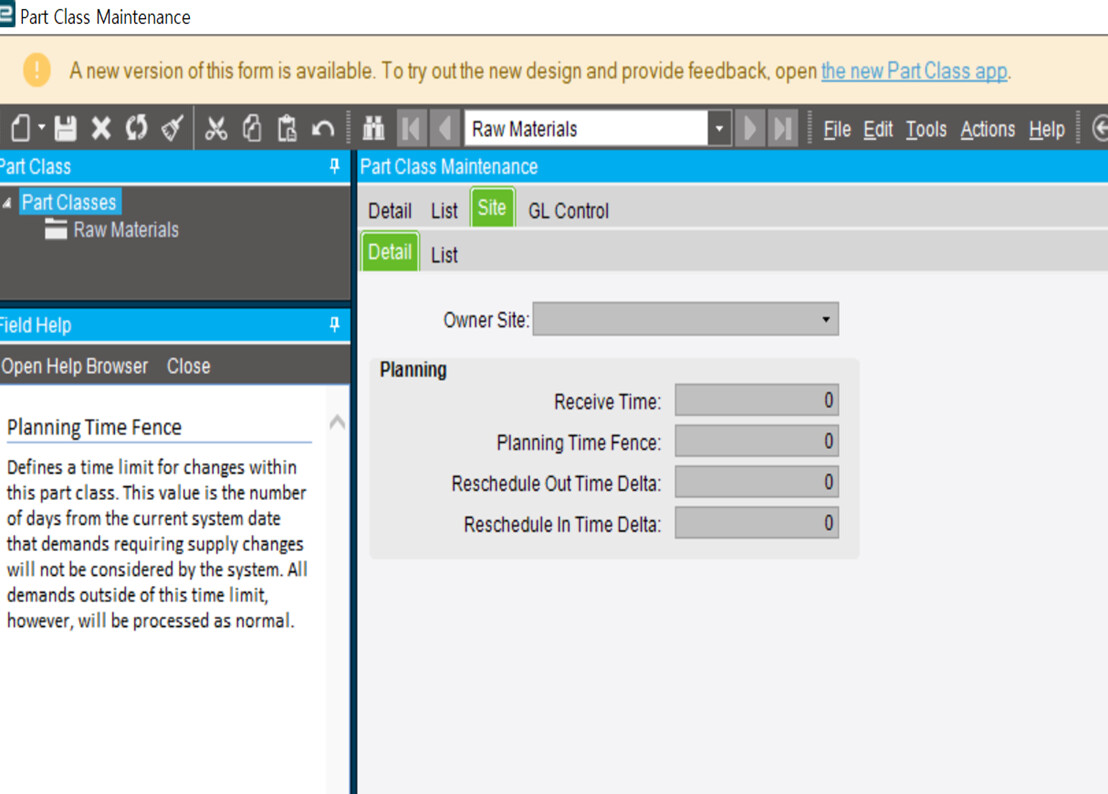

You want to use the Planning Time Fence, Reschedule Out Delta, and Reschedule In Delta to control change suggestions. They are found on the Part-Sites-Planning tab.

It seems that my question about time can be solved through the Time Fence setting. (Postpone = Set Reschedule Out Delta, Expedite = Set Reschedule In Delta)

Set your Planning Time Fence to something large like 999. That will get rid of any suggestions within the time frame.

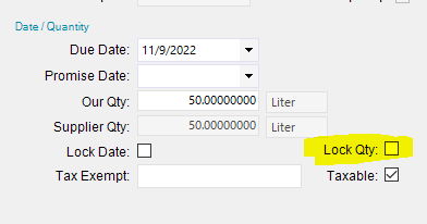

There are different ways to handle this. There is a field at the PO release level specifically designed to tell MRP to not suggest a change in qty:
