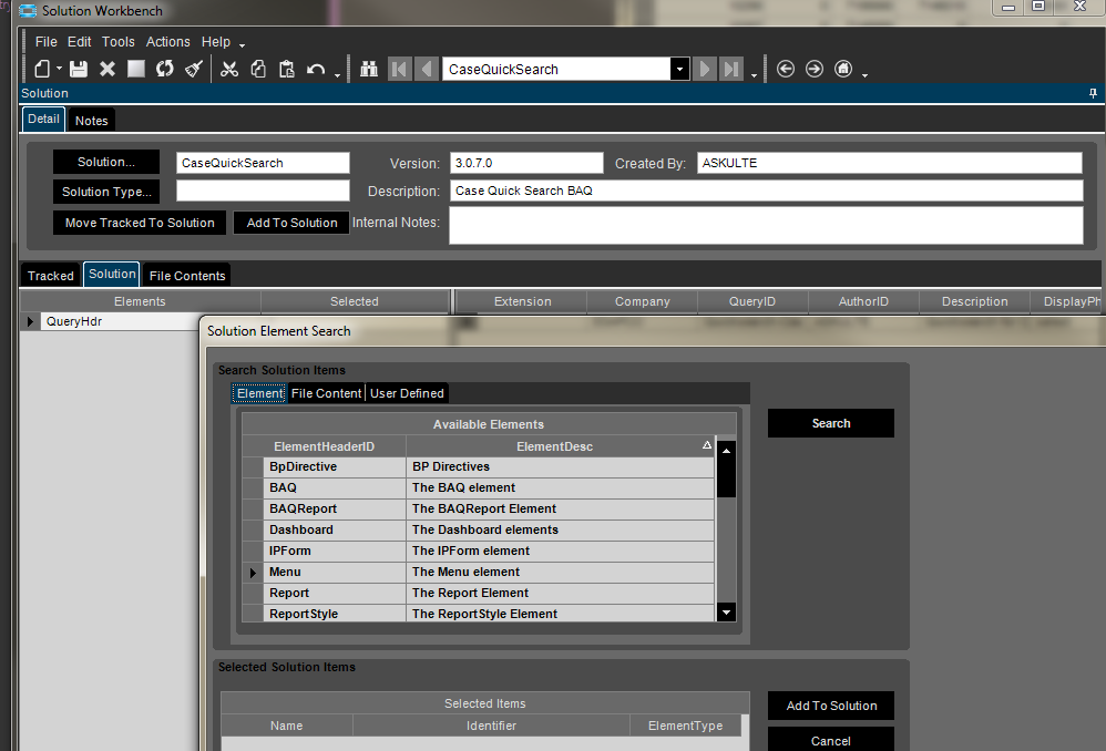

Is it possible to add quick searches to a solution workbench? I just created the BAQ and a Quicksearch in PILOT, tested it, and would love to deploy it in LIVE (rather than re-creating it).
Easy enough to add the BAQ to the solution, but I didn’t see where I would add the quick search (via the ‘Add To Solution’ button and Element tab).

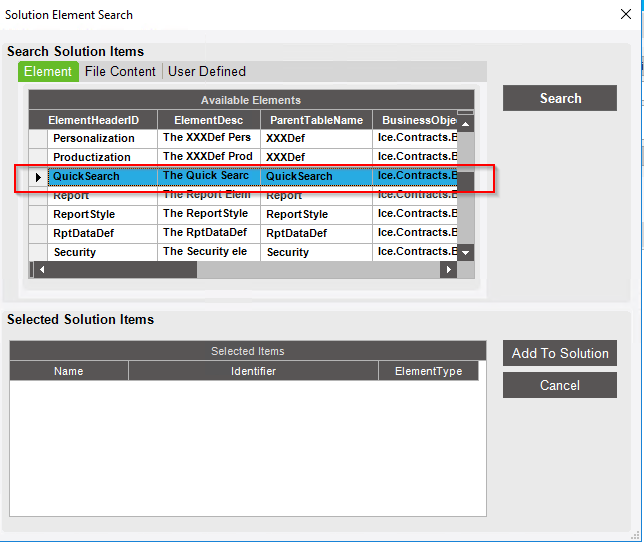

Don’t you have this listed if you scroll down?
if not, you could create new entry -

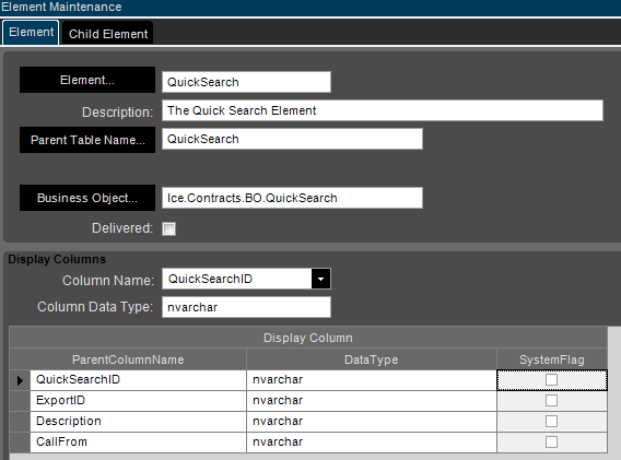

I didn’t have it in 10.0.700.4, but do in our 10.2.200.5 test environment. I followed your screen shots (and application help file) to add QuickSearch via Element maintenance (including the 4 display columns).
10.0 has an extra checkbox of “Delivered”. Help states: Delivered - When selected, this check box indicates the selected solution is delivered with the Epicor application. I’m not quite sure what that means, and whether to check it or not.
Thanks for your help!
Here’s how it looks in Element Maintenance so far. SystemFlag is also not checked, like it is in the 10.2 out of the box QuickSearch element:
