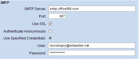

Does anyone use SMTP and O365? Our setting don’t seem to be working; I am hoping someone can help out with this.
Capture
Those settings look right (they match ours and ours works). It’s going to be a setting in office 365. You did set up that e-mail in your office 365 right?

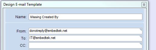

When the Email is being created we need to use the donotreply@embedtek.net user as the From
Capture
Or just leave that blank and it will default to the company setting.
PS: The only Reason I have my own GetCompanyAddressAction is because it was getting the wrong Company if left blank in a Multi-Company Environment in 10.1.500.x
