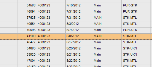

I know it’s been some time since this thread was active but I thought I’d let you know that you should check the case of the Bin and WarehouseCode on the PartTran records. For example, this transaction breaks the report for us. You’ll see the Warehouse Code is “MAIN” but it should be “Main” like the rest of them.
This is still an active part and we continue to issue it to Jobs but the report will always say the last transaction date is 8/8/2012.
The SMS Report is case sensitive which causes it to populate incorrect data when the case is different than the foreign key. I have an active case open with Epicor but I’m not gaining any traction trying to convince them that the case sensitivity is the problem. You can request a SQL fix to correct anything in the past but the UI programs that create PartTran records are inconsistent when populating those fields and the BO’s do not correct the case prior to submitting the record to the DB. So any future transaction may exhibit the problem. It is still broken as of 10.2.300.10.
