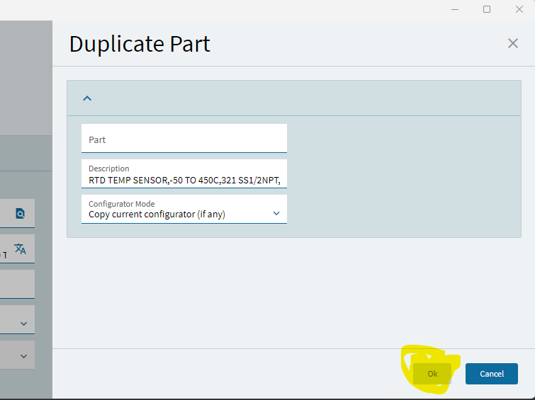

Are you talking about buttons you add on the slide-out page itself? Like below?
Can’t say I have a definitive answer… but there’s an ID there.

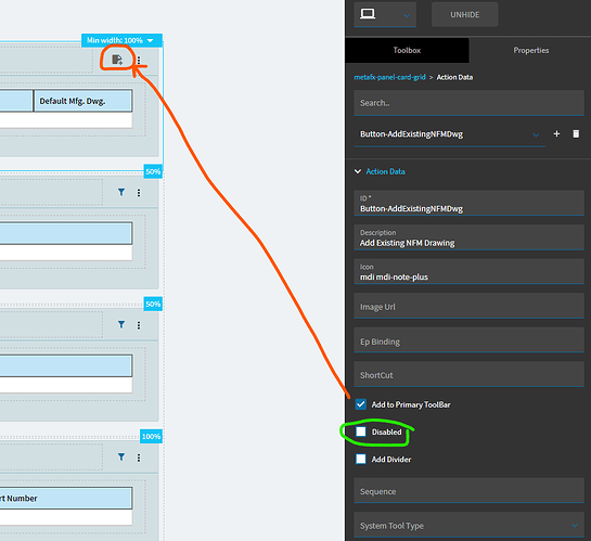

You can add a button to a panel card/grid under Advanced > Action Data.
Those have the ability to be disabled… if that helps at all.

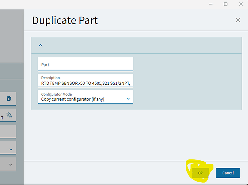

I just tested against a “stock” page button on Part Entry… if the button is mapped to TransView… you can disable it with a row-rule.
Rule:
Result:
I did a second test with the “Ok” button… and it worked there too.
again… not sure if it helps, but may be a workaround for you.
Awesome! I will give it a try and let you know.
So, it works, but I can’t enable it later on. What is happening is I want to enable it if a certain field = value. The fields I am checking are in TransView and get created on the fly. When the first field gets created and set with a value, it enables the button again, regardless of the value. While you gave me a way to do it, it does not work later on. I am going to go with your original suggestion of creating the buttons myself and not use the OOTB.
