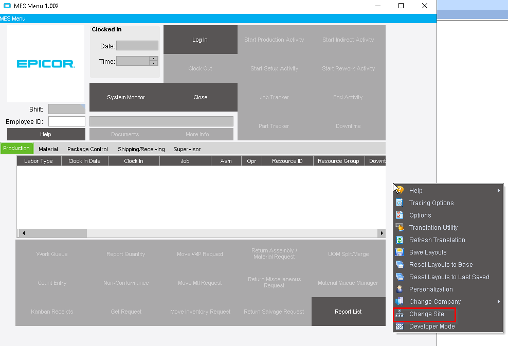

In 10.2.200 you can change sites in the MES by right clicking and selecting Change Site. Until this came along we had a generic user account that allowed for access to only one site. They would have to sign out of MES and back in with the other account.
