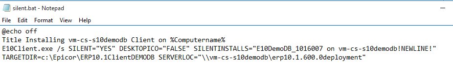

I’m trying to use the silent.bat file that Epicor creates to do the install instead of having to get the local resource to go around to each computer to install it.
I can’t get the batch file to work though. I tried what was created and have also tried editing the batch file directly to see if it is something in it. Everything I have tried still does not work.

You can remove the @echo off from the batch file and add the word pause as the last statement to see what is going on. I would also probably have the user right-click and Run as Administrator when they do this.
  1. Are the client prereqs already installed on the workstation before the silent .bat is launched (i.e. .NET 4.6.x)?
  2. Is the user that is launching the silent.bat a member of the local admin group on the workstation?
  3. Have you edited the silent.bat to include the UNC path to the e10client.exe?
BEFORE:
AFTER:
  1. If none of those are it, launch a command prompt and call out the silent.bat that way, to see if there are any errors that appear.
