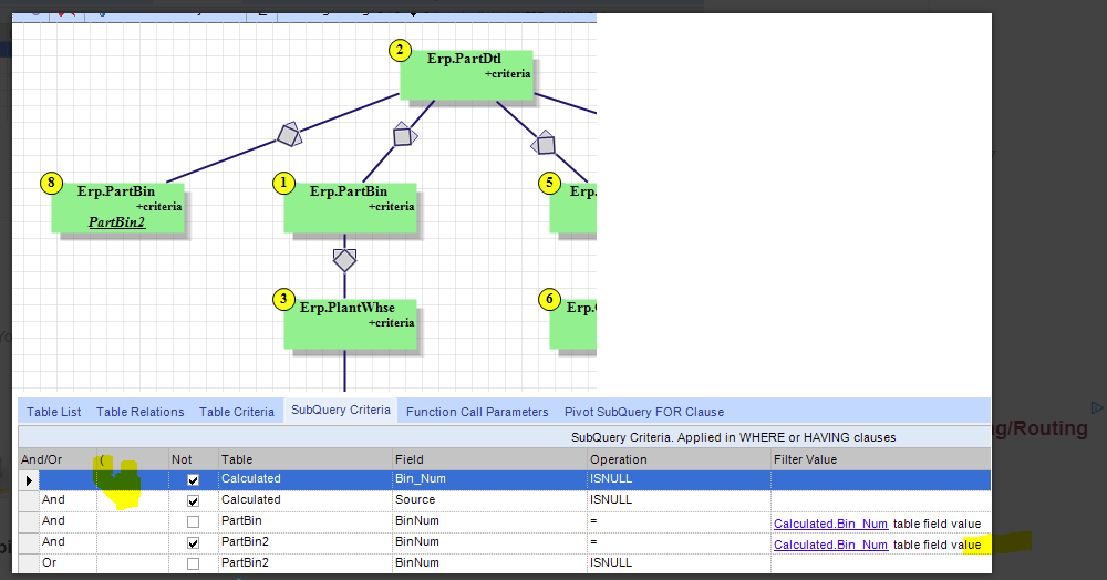

I have a BAQ that shows the bin number and OnHandQty derived from ‘PartBin’ based on user entered part number parameter. Since most parts are located in multiple bins, I have another ‘PartBin2’ table that shows the bin number and OnHandQty of the 2nd bin.
The problem is, if a part exists in only one bin, i.e. if there is no 2nd bin, then the BAQ doesn’t show any results.
I’ve tried left joints and right joints, none work.
I have already applied these filters and failed:
OR where partbin.binnum = ’ ’
OR where partbin.binnum = 0
OR where NOT partbin.binnum ISNULL
OR where NOT partbin.binnum <> ’ ’
OR where NOT partbin.binnum <> 0
I have also tried to use these calculated field and failed:
case when PartBin2.BinNum = ‘0’ then ‘x’ else PartBin2.BinNum end
case when PartBin2.BinNum = NULL then ‘x’ else PartBin2.BinNum end
case when PartBin2.BinNum = ’ ’ then ‘x’ else PartBin2.BinNum end
I would like to see the results with the binnum and qty, and blank results on binnum2 and qty2 if it doesn’t exist.
Any help would be much appreciated.

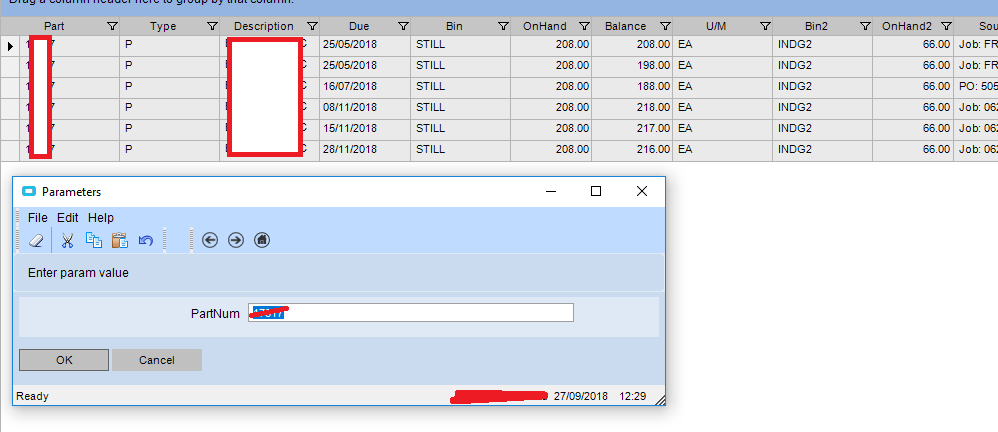

OK so without going into details,
When I enter the part number in the parameter field, it shows the bin number under “Bin”, its “OnHand” Qty and the balance after each transaction.
I added Bin2 and OnHand2 based on “PartBin2”. which shows info from other bins.
If other bins dont exist at all, i get no results in the baq.
don’t you need a brackets to put the first 3 logical statement together against the OR (last one)?
thanks, tried but didn’t work.
More likely brackets around the “Or” conditions?
thanks, tried, also failed.

please copy and paste in the query phrase. I am guessing that you will need to make a subquery for partbin.
That way you can show all bins for the part instead of having to keep adding to the BAQ with criteria’s’.
