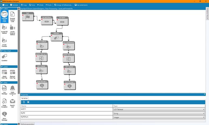

Show us your bpm…
Do you need inner details for anything?

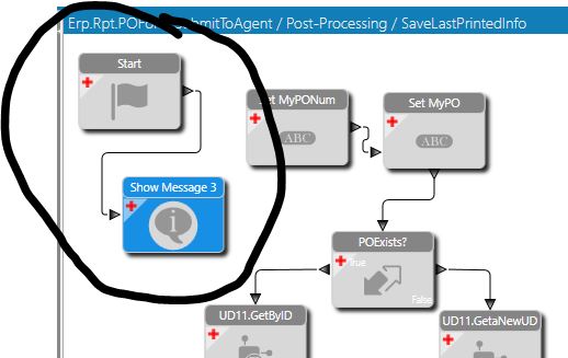

Even this isn’t working. Weird, right?
Capture5435435
I just tested on my 2022.2.11 and it worked.
