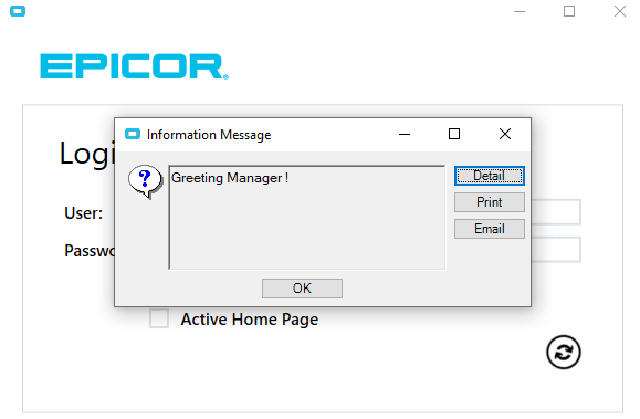

@Mohamed_Yusuff_S, I found your query interesting and KUDOS!! I found way to greet your user:

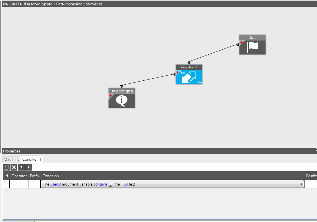

I have created BPM on Ice.UserFile.IsPasswordExpired Post Process method to show Message Box. Try it out and let me know how it goes…
Hi May i know have you given any condition to the bpm or at the start you just showing msg.
My Version is :- 10.1.600.36
Hi I tried in by giving condition or just showing msg at the start but it doesn`t work.
No I have given message directly without any condition.
i tried that too but it didn`t work …i have tried almost all the userfile bo methods none of them works which version you are using ?
It’s 10.2.400.5.
oh might be thats the issue its not triggering the bpm.
