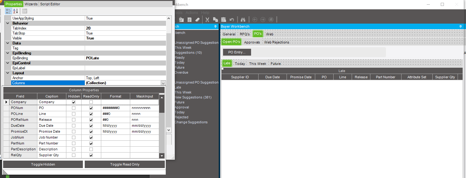

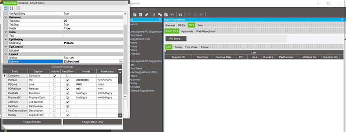

Our buyers would like to be able to see Arrived status on Buyer Workbench. The grids in on the screen don’t show all the PORel fields; it looks like they are calculated / pulled from a temporary table.
So to show the Arrived column here, I suppose it would have to be done with custom code?
Is this the direction I need to go? Looks like a LOT of work…
