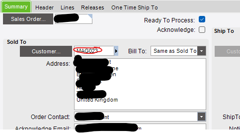

Yes you can just change the Sold To Customer ID:

And that’s the order that was partly shipped already? I’m just surprised it is not grayed out.

You’re correct - it looks like you can change the order if jobs exist, but once one line is shipped then its greyed out. So for some of our orders that answers the questions anyway.
